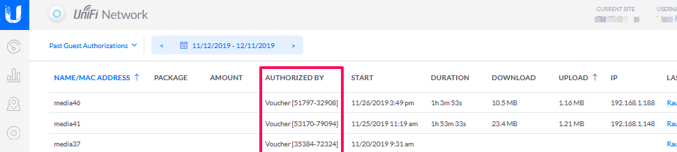

@slooffmaster Thank you for your quick response!You mentioned "Past Guest Authorizations":And I checked and saw there some interested column "Authorized By" there: https://img.community.ui.com/263cb4c3-62cc-432c-90ae-87227df6a4b4/answers/7d43d3a3-ab3c-450c-8578-f95fbf7a883b/d9db8c4e-593f-4b20-b422-14ed8055b97e There is only the field "authorized" (true/false)  in the api's stat/user and /stat/sta responses.And nothing like as "authorized by"...Regards,Alex.
@banato We don't use the built-in vouchers that often in our projects so I don't have any test data to validate. You can either download my API Browser tool to go through the collections yourself, or we can discuss offline so I have temp access to a site of yours that does use vouchers._________________Art of WiFi - Check out our UniFi API browser tool on GitHub. The PHP API client which it uses, can be found here on GitHub. The thread on our UniFi Device Search tool can be found here, also check out our Captive Portal solutions for UniFi.
