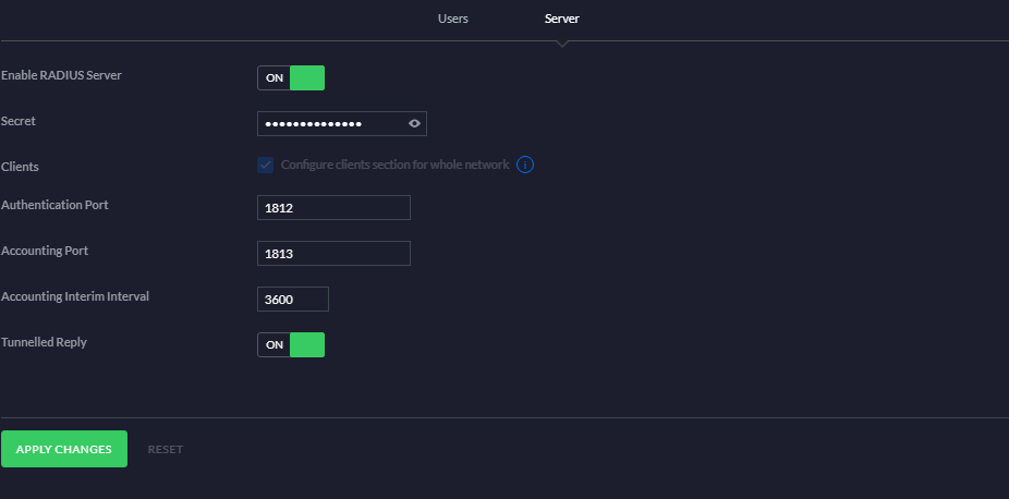

https://i.gyazo.com/abe2bf3e2da6de08e640f78045ade004.png
https://i.gyazo.com/ee124a2c02e36da11ceb297331c72aac.png
